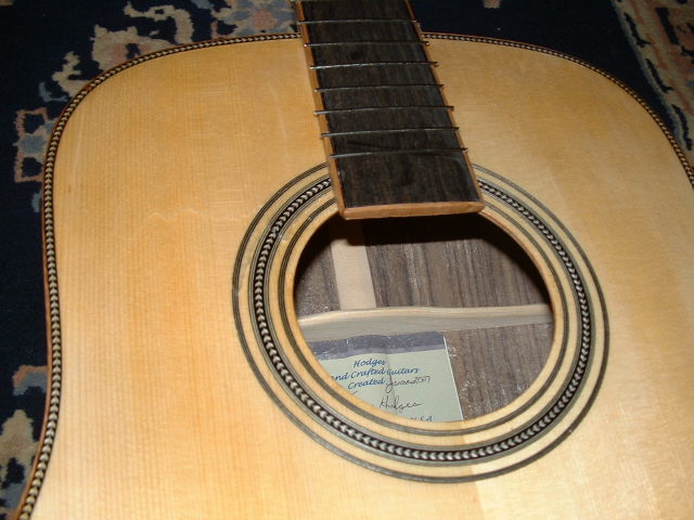

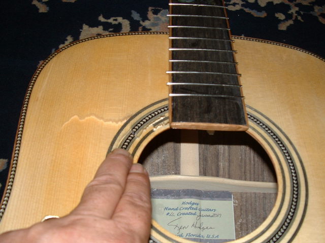

I didnt see anything wrong at first, but when I set the guitar down I could see what appeared to be a crack in the finish....
It wasnt a crack in the finish....
I'm not prone to outbursts of expletive language or panic attacks, but this one was over the top.... or was about the top anyway.

You hit the proverbial nail on the head with your statement "so without thinking about using the steel caul I gave it just one more tap". Lesson learned - never hammer frets into an unsupported neck or fingerboard extension. This top should be framed and hung on your wall for future reminders.

After reviewing your pictures and the way the top is cracked I am inclined to believe the top failed due to excessive run out. It can be seen at the center joint and is quite prominent. The way the top cracked, cross grain, and at what seems like a 45*-ish angle through the wood almost leads me to believe the wood had an internal flaw combined with excessive (and even quite possibly localized) run out. In my mind the wood should have cracked along the grain and not across the grain. This is a strange failure for just a light tap with a fretting hammer.

[QUOTE=Tim McKnight] After reviewing your pictures and the way the top is cracked I am inclined to believe the top failed due to excessive run out. It can be seen at the center joint and is quite prominent. [/QUOTE]
I agree with Tim.
The big color/reflectivity change between the top halves points to the runout, which was revealed dramatically when you gave the top a 'shock'.
In a way, you're lucky you found this flaw in the top before the guitar got into the customer's hands.... just repeat that enough times and you may start to believe it! I do share your pain (as the famous say).
I'd have a good look at the rest of the tops from that lot as well.

Since it is not an open split along grain, and if there is no offset on the rosette and the crack stops at the fingerboard, and with the easy accessed near the sound hole, maybe it's possible to glue it back with hide glue, spot sand, and refinished.
